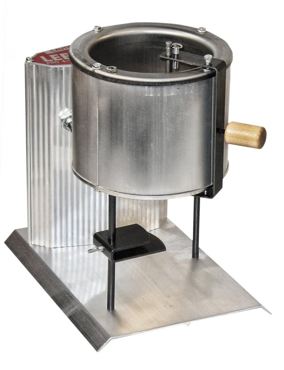

Thought id also post which furnace I use for casting. The Lee may not be the best out there, but its hard to beat for the money
https://www.amazon.com/Lee-Precision...asting+furnace
