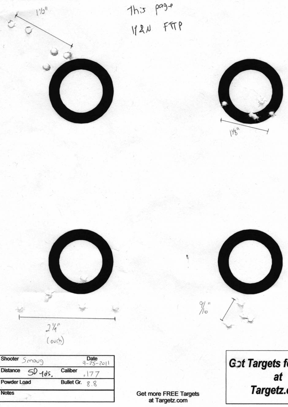

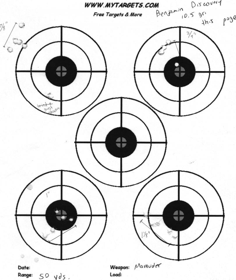

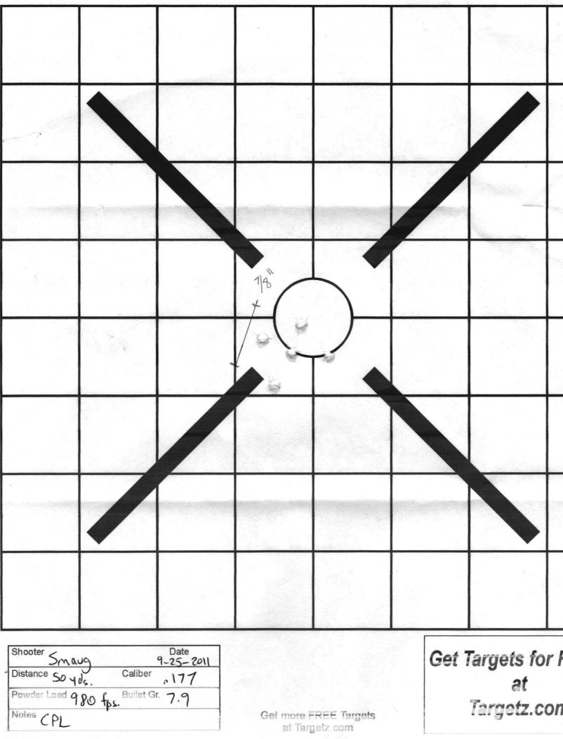

The groups could've been a little tighter if I'd had a support for the rear of the stock.

Default Here are some 50 yard groups with different pellets
ID:	17   Click image for larger version
ID:	18   Click image for larger version
